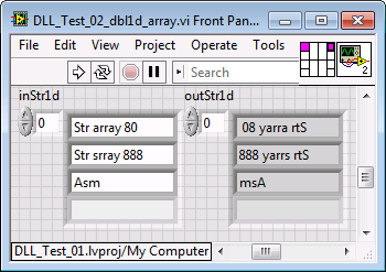

1. there is a vi including 1D String of array control and indicator.

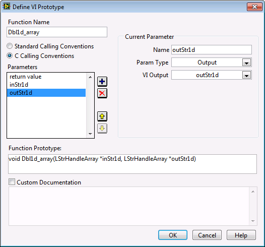

2. made this vi to dll with Build Specification-Shared Library(DLL).
 function definition in header file is below.
   --> void __cdecl Dbl1d_array(LStrHandleArray *inStr1d, LStrHandleArray *outStr1d);
and definition of LStrHandleArray is
typedef struct { int32_t dimSize;
                        LStrHandle String[1];
} LStrHandleArrayBase;
typedef LStrHandleArrayBase **LStrHandleArray;

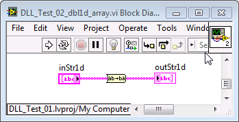

3. want to use this dll in new vi.

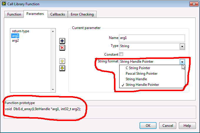

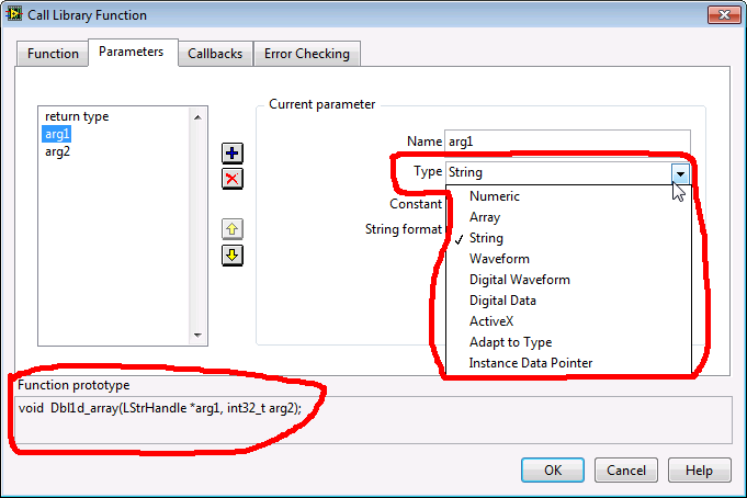

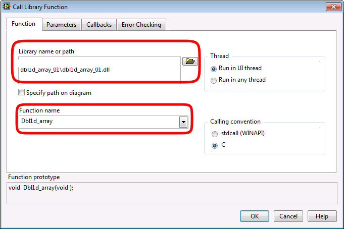

  • call library function - configure.. -select dll file created above and function name parameter :
--> parameter tab
??? What type and format should I select for LStrHandleArray *inStr1d in the header file of dll???
Help~!!
Thanks.
(5,034 Views)
Try "Adapt to Type" with the Format set to "Array Data Pointer." One way to find out if the types match is to set up the Call Library Function Node (CLFN), wire all the inputs, then right-click the CLFN and choose "Create C File." Look at that C file and see if the parameter types match the prototype of the function you want to call, in the header file.
(5,009 Views)
Accepted by topic author nara
The parameters are Arrays of LabVIEW strings. So you simply create such an element on the diagram, wire it to the according parameter configured as Adapt to Type. But don't use Array data
pointer but rather Pointer to Array Handle.
