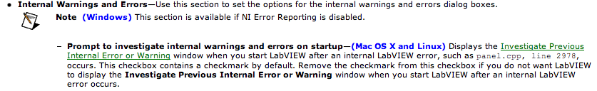

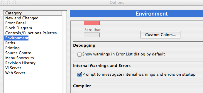

Try unclicking "Prompt to investigate internal warnings and errors on startup" under Preferences (or Options) >> Evironment >> Internal Warnings and Errors. It is chekced by default.  I leave it on, but I think turning it off may be what you want. I copied the detailed help for that preference also.
Lynn

that has no effect. It is not about messages - it is about loading and sometimes even executing vis which were loaded during crash/kill.
