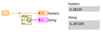

Numeric indicators are typically single line (but there are exceptions) and the control height is determined by the font size as has been mentioned.
If you want an indicator of arbitrary height, use a string indicator and display a formatted value of the numeric.

What are you talking about?  If you make the font larger, then the font gets LARGER.
Example_VI_FP
Of course you can hook up some external display if that makes sense for your situation.  But it sounds like overkill considering your original question was how to make the numeric box larger on your front panel.
