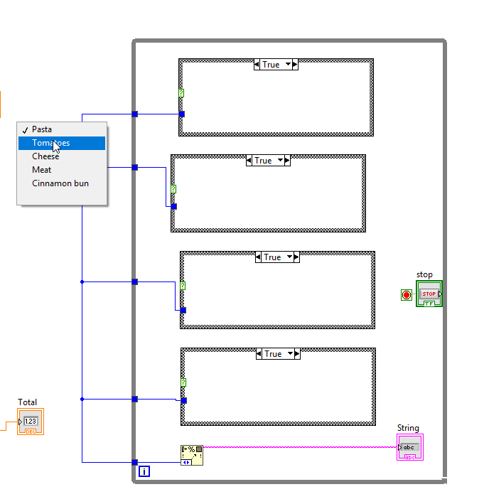

Hello, I have a labview assignment task that I have to do.
Currently, this is what I have done.
I'm not here to ask if someone can finish the work for me or etc, rather I seek guidance on how to finish this task.
What should I look for (search on the internet) to solve this, as this is my main issue. I have no clue on what to search on or in what way to do this. Am I supposed to do this with case structure, boolean, array, events etc?

Hey, I'm sorry to have it in bad format. It looked fine from my perspective, I'll re-upload a new one. This is not a LabVIEW class, this is our electric car project, that's what the class is called. We built an electric car and make it function with MyRIO. Everyone gets their own assignment, so no point asking other students. Yes, the material has been read, I have some hum on how to do it, however not sure if it's correct and I get stuck a lot.
Enhance the 'Buying food' program:The program should run until you press a Stop button (which you have to add).That
Subtask 1
Add a string Indicator that suggest what you should cook.
The output should be: 'I suggest you should cook [dish]'. Where [dish] is replaced by:
Pasta all'arrabiatta, if the user selects pasta and tomatoes only
Spaghetti bolognese, if the user selects to buy cheese, tomatoes and meat
Pasta non-definito: if the user selects to buy pasta and cinnamon buns only
Output: 'I have no idea what you should cook!', in all other cases
Subtask 2
Advertising your products is important to run a business. Add four LEDs to make a small lightshow. One LED is shining a time. The shining LED jumps from LED 1 to 2, from 2 to 3, 3 to 4 and 4 to 1 and repeats. As higher the total price, as faster the LEDs move.
Message 5 of 17

I tried with a string indicator using case structure, however, then it uses boolean which won't work in my case?
Message 6 of 17
(5,862 Views)
Why does 'it' use Booleans when you use a case structure that outputs a string indicator?
Better post some code to show that attempt.
I still don't see how your solution so far matches anything in the image of the assignment. Is there more to it? If you only tell us 1/2 the problem, you'll probably get 1/4 of the solution or less.
EDIT: I'd go for an enum with the four dishes, and put it into a format into string to display the required output string indicator. That should take part of the first assignment. And if this doesn't make any sense, the free online courses might help...
Message 7 of 17
(5,856 Views)

You mean something like this? Should the enums be seperated or can I have multiple items in one?
EX2rGMAEX2rGMA
Message 9 of 17
(5,809 Views)
Try wiring up the enum to the case structure [?] and see what happens.
