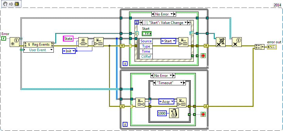

I'd like to ask the similiar question about the error handling in the producer-consumer loops.
I usually check the error as entering the loops but I'd like to know if there are some problems in my architecture.
Could someone please give some suggestions or advices? I would appreciated a lot!!!

Hi William,
rather than wrapping things up into a case structure, a common way of detecting the errors is to put a VI after your state machine case structure in the consumer loop. This VI can look for errors and enqueue the next state (either an error handling state or a shutdown state) and you can communicate this back to the producer loop using the user generated event.

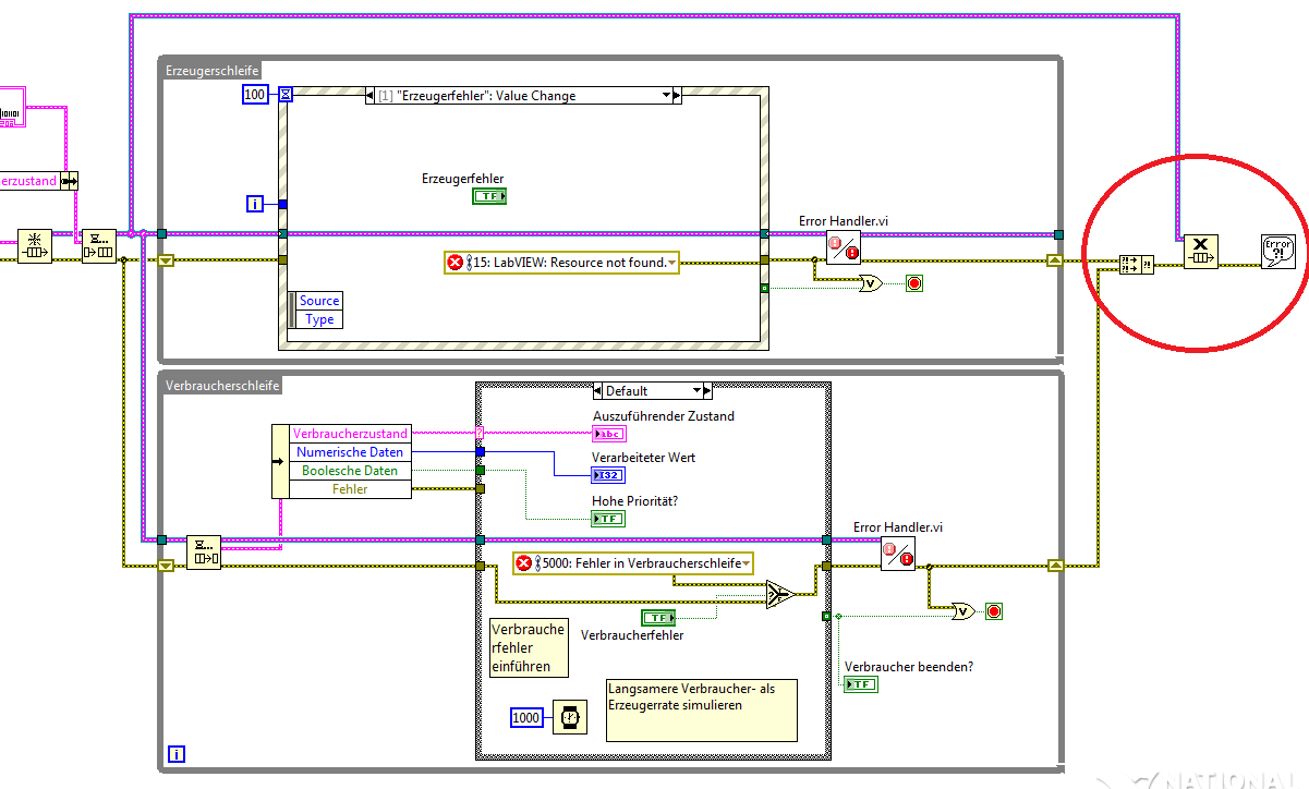

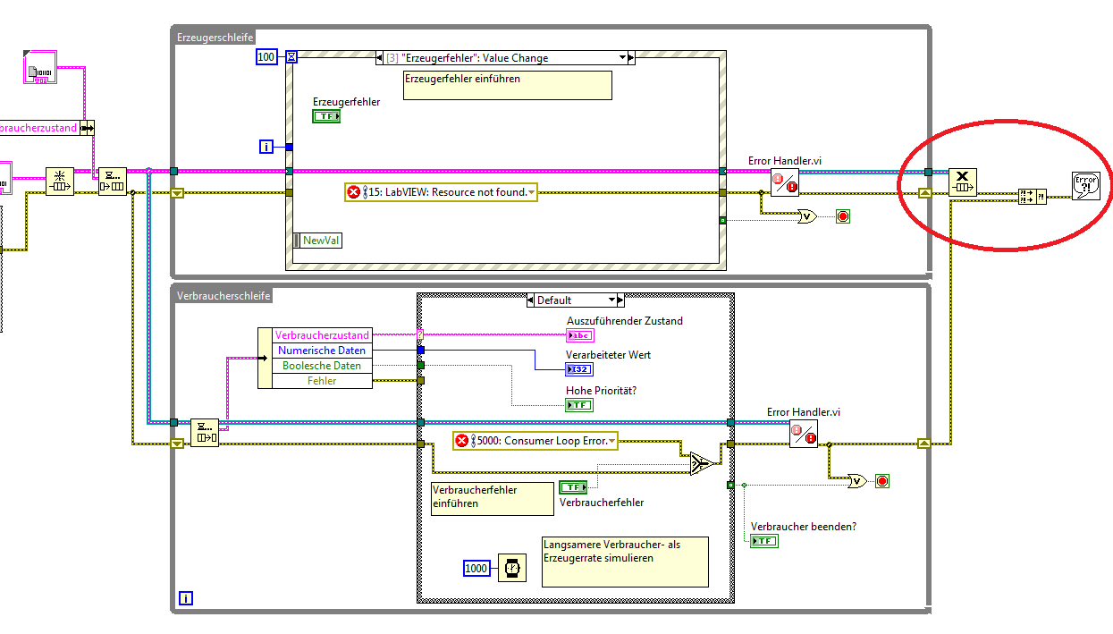

Here is the official solution:
And here is my suggestion:
I think in the official solution, the queue gets released too early. (the consumer loop could still need it)

Your solution creates a situation where you may not release the queue. If you pass an error into it, it will skip that.  That happens if either loop experiences an error condition.  Also, why did you rewire the reference above the producer loop?  Keep the code clean and simple and just wire it straight through.
If you're concerned you might lose a few elements in your queue with that release, the fix is not to change the order of the merge and release.  You've just created a new problem.  Instead, you can add a while loop before the release that operates with a Get Queue Status and stops with the condition that the queue's size is zero.  That loop will execute until the queue is empty and then move on to the release.  With this, you're not leaving yourself with the possibility that you'll never close the queue's reference.
