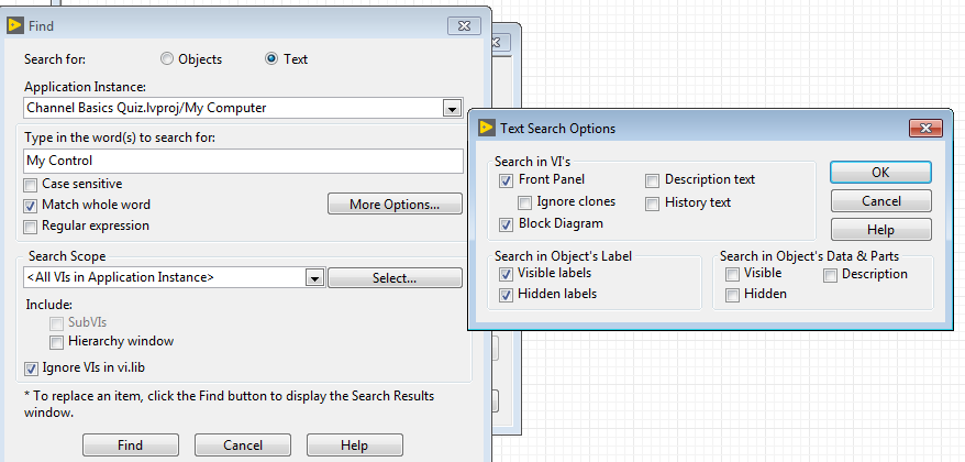

Thanks, today I have learned some new stuff 🙂
