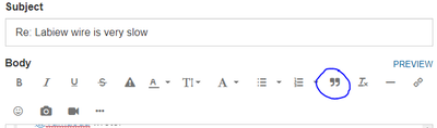

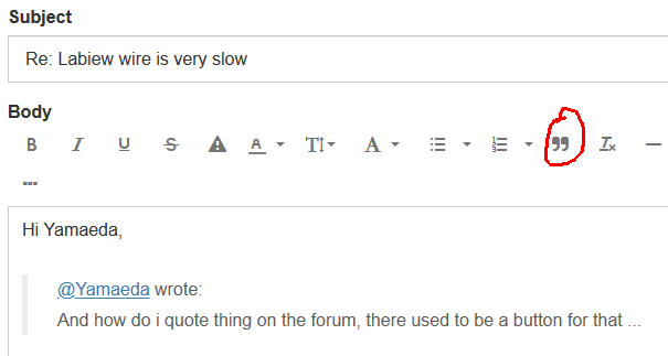

So how can you find these crazy objects? Do VI analyzer help or is it just trial and error?
(And how do i quote thing on the forum, there used to be a button for that ...)

Hi Yamaeda,
See here:

Yamaeda, quote using the quote-button 🙂
