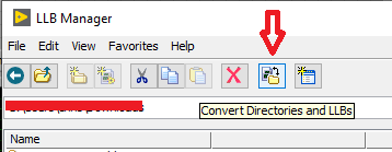

The llb manager has a tool.

@altenbach wrote:
 wrote:
Where is this tool of bounty that you speak of?
Wrong way!  That tool converts a folders contents into an LLB. 😄
Bad tip strip.  Have you used it?
It claims to be bidirectional... but I don't ever find the right way to get anything out of it but a llb extension in a single file with an odd icon looking like an lvlib at that new location.. mlm
Maybe the tool is as obsolete as the llb...perhaps I'm not setting the right ini options...

My link given pointed to the correct direction (llb->folder). I haven't used any of this since the mid nineties, so I am not sure how well these things work. They worked back then, if I remember right. 🐵

open the LLB in the LLB manager.
Select all the files in the LLB.
Cut them using the scissor.
Paste the files in a folder…
Keep an eye on unusual file names of files inside the LLB, they might produce problems when moving the files to standard Windows folders…
