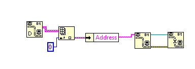

Yes, i know the address of my device. I tried to directly connect to the device but actually i get Error 54. Please notice that i obtained the same error even using my smartphone, so probably i'm doing something wrong. This is the code that i used to test BT VIs with my smartphone:
Maybe i need to use RFCOMM to look for service before the connection?
(5,799 Views)

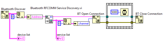

Dear Licia,
actually i have been able to make a connection with my smartphone thanks to your suggestions. I got rid of Error 54 using RFCOMM Discovery Service. I suppose the problem is tricky to detect because of the Open Connection.vi working method. In fact, due to the fact that you can wire channel or UUID to this vi, no one of these input is mandatory and VI can be run (giving the error as result). This is the code actually working to establish a connection with my phone, i'm posting it because it can be of any help for others:
Now i'm going to try some experiment with my BlendMicro, hoping that the workaround with the address can work in a similar way. I'll keep you updated
