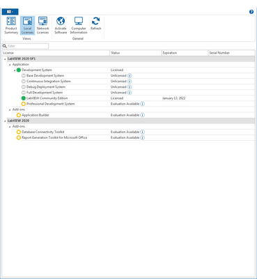

I read the complete thread and followed the advised procedure. The result is always the same: the LVCE 2020 SP1 activation apparently is not complete, as you can see in this screenshot:
The expected result would be that all nine components would be licensed.
If I understood the explanation about the LVCE right, it should contain the same components as the professional edition. It that's true, I don't get why 8 of 9 components are not licensed.
Do I get something wrong?

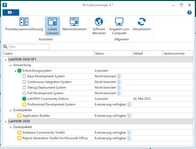

Don't worry; what you are seeing is correct.  Community edition includes all App Builder, the Database Conn. Toolkit, and the RGT "inside" of it.  It is normal to see the separate packages for the add-ons as Eval.
In fact, I am surprised to see them in "Eval" status.  This is what mine looks like:
Bill

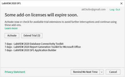

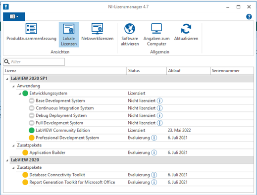

I did a reinstall and this time I did not activate anything but the LBCE bundle. License Manager list the same licenses as in your case:
But I am still a bit unsure about whether the toolkits are included in LVCE, since every when I start Labview I get this message:
So the toolkits are just a trial? Will the toolkits be still available when the 7 days will be expired? Do I have to extend the trial or what?

I followed your advice to do a clean uninstallation of all packages including the hidden packages.
The result is the same as before - the three add-on toolkits are reported to have a 7 days trial period.
I have no more ideas. Maybe I should just wait the 7 days and then check whether the three toolkits still show up in NI package manager?
My guess is they'll show up as expired evals, but your LV Community Edition will still be completely intact (meaning you can still use all the add-ons as if they are not expired).
As I mentioned earlier, LV Community Edition contains those add-ons inside its license.
