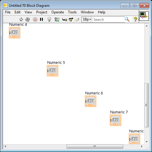

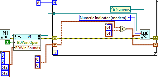

Looks like LabVIEW is taking some liberties with positioning  on the Block Diagram. I can't place them outside the Block Diagram viewable area. I made a small example VI (attached) which is supposed do create 8 evenly spaced indicators:
And here is the result:

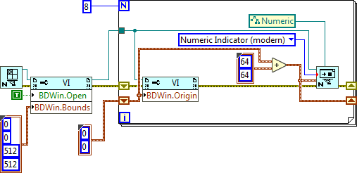

b/ Moving the BD origin before placing the indicator:

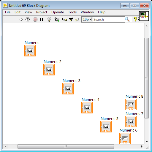

  but here again, LV seems to take some liberties with positioning because resulting indicators are not  evenly spaced:

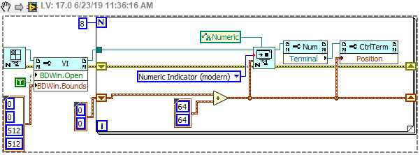

Apparently, the New Object is placing the control at a specific position n the front panel.  It isn't putting it at a specific position on the block diagram.  So it must be using LabVIEW's default rules for where to place the terminal, just like when you manually create a control on the front panel, the terminal seems to wind up in places that sometimes make sense, and sometimes don't.
What you can do is get a reference to the terminal of that newly created object, and assign the position to that as well.
indicator-position-test_BD
(3,794 Views)
Moving the terminal does work.  Thank you very much.  Smiley Happy
