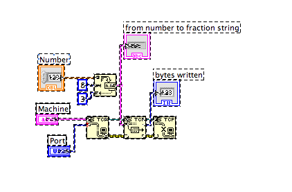

I finally got the program to work. I'll paste a diagram here in case it helps someone else:

@ashenoy wrote:
Thank you for inputs, rolfk and Lynn.
The issue was that C was not able to handle the byte stream when I used the "Flatten to String" function. So I used the "Number to fractional string" function, and converted it back in C using the function atof(). This way, I think the solution is endianness independent.
Well, you got rid of the endianess problem and replaced it with a decimal problem. Not likely to happen if both computers use english localization settings but definitely going to be a problem if at least one of them is situated in a locale that uses decimal comma instead of decimal point!
Rolf Kalbermatter  My Blog
