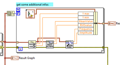

I even had a service ticket active at NI, which i will probably need to open again, because of this issue. The dump file was analyzed and it was leading to Waveform Min Max.vi. I am calling this VI in a for loop, using parallel iterations. can this cause the memory corruption?
I don´t think the Waveform Min Max.vi itself is the issue, but combined to this parallel iterations might lead to unexpected behavior and LV crashing.
