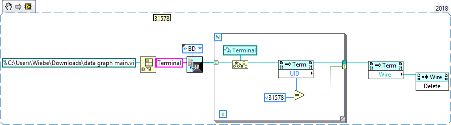

Fixed it!
Spoiler
Opening with Open VI Reference still worked.
That corrupt list is connected to a terminal, with UID=31578. Deleting the connected wire solved the problem!
