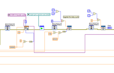

Hello. I have a LabVIEW code that crashes if I insert delay5 of 1 h. I need to make measurements every hour. If there is a small delay the program works fine. If there is 1 h delay, the program freezes and I have to restart everything. There is no error indication or anything. I am attaching the picture , I don't have a VI right now and I know that you cant debug a pic, but if you have any suggestions how to debug it, I will very grateful. Delay ( is the only thing that I change in the code.

On your image: Too many ExpressVIs, too many local variables, a lot of RubeGoldbergs…
Suggestions:
Having a single function set to wait for 3600s is a PITA in terms of UX. Instead there should be a small loop set to iterate upto 3600 times with 1s delay inside and an additional stop button to break the loop.
And there should be a state machine instead of a long sequence of steps…

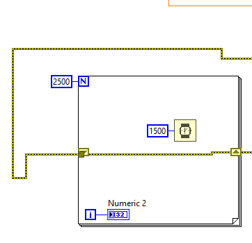

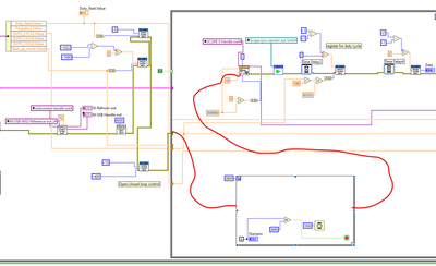

I replaced my long delay with the loop, you can see on the picture. After 2 measurements are take, on the third one it crashes - the file is created with no data and I can not even stop the program, I have to restart everything. The same problem as I had with delay of 1 h. So the loop didn't help

You should have a stop button connected to the for loop termination.
The issue probably have nothing to do with the wait, or rather not directly. You instrument probably gets a full buffer (due to the wait) and overflows. Check your settings so you set it to finite samples and such. What's the error code out?
