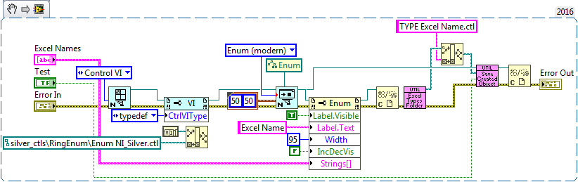

Actually, I did use scripting to create an Enum.  I was working on a data acquisition/control project that was driven by an Excel Worksheet that had (I'm guessing) about 150 row or column headers that became associated with the variable saved in that row/column.  For example, one column was called "Trial Index", and when the Excel sheet was read, the data were put into an array indexed by the Enum.  So if I wanted the "Trial Index", I just used the Enum as the index into the Array and got out the value (there's more to it than that, but that's the idea).
Data Structures are never "static", as we keep dreaming up new things to do, which we accomodate by "adding a few rows/column to the WorkSheet".  Grumble, this means a new Version of the Code, with a new building of the Enum.  I wrote a stand-alone program to do this -- it parses Excel, figures out all the Excel names I need, then using Scripting, builds an Enum with the names written into the Strings[] property.  It seems to work ...
Bob Schor
I'm going to try to attach this as a Snippet.  There are some sub-VIs that do "obvious things", but most of the code should be evident ...
I should mention that I've run this using LabVIEW 2012 and 2014 -- I'm hoping to migrate (and restructure) the code with LabVIEW 2016, but it hasn't happened yet.
