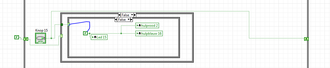

While you your teacher may have told you to do it that way, your VI contains a remarkable number of pet peeves and practices that are considered bad practise around the forums or for LabVIEW programming in general. Just from a cursory glance I can see:
  •  Stacked Sequences: Flat sequences inside flat sequences?! All that was needed there was to add more frames to the base sequence. While flat sequences have their place, they are used here in place of proper dataflow.
  •  Local Variables: Used in an alright manner for exiting two parallel loops, otherwise though, how are you going to try and determine where a value has been set when trying to debug anything.
  • Opening/Close DAQ: All of the opening and closing of the DAQ ports is not only unnecessary, it is slowing down your program. Moving the opening and closing of these outside your loop would speed up and simplify your program.
  •  Timing control: Is there any timing control throughout your loops? From what I can see the only thing stopping your program from saturating your computers CPU is the time that it takes to wait or write the DAQ commands.
  • SubVIs: There is not a single sub-vi in amongst all of this program that I could find. Not only do they make it easier to navigate a program they can also help make it easier to understand and look tidier too. Even if all your DAQ open/write/close or DAQ open/read/close clusters were contained in subVIs the entire thing would look much nicer.
I'm sure there are other things to point out, if some of the more experienced guys here could take the time to narrow it down (I'm only a CLAD), and amongst all of this there is the problem of lack of some simple programming knowledge, you could simplify all of your boolean to number conversions by using two subVIs, Build Array and Boolean Array to Number.
This is not to diminish the amount of work that you have done to get this project working (I presume it works, I haven't got the hardware to test) but through use of proper techniques and development this project would get significantly easier to maintain and/or bug check.

OK, we have confirmed that this is Homework.  So, we will give advice not answers.but, lets look at this structure that you have repeated 16 times
if you hold the Boolean (with a switch until released action) read the value once and write it to 3 local variables  (Yes the inner True case looks exactly the same with a True Constant)
Why  not make the control a latched Boolean?
