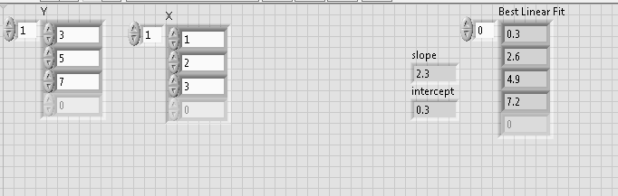

Capture.PNGsnip.pngIn this simple vi I expected intersect to be 1 and slope to be 2.
What am I doing wrong?

either the implementation changed from LV2011 to your LV2015 - or you did some wiring wrong (which I can't check right now):
The error is with your array indexes! Arrays start at index 0 - but your FP elements show only elements starting from index 1!
You should have noted you get an array with 4 elements as "best fit", while you think you only input arrays with 3 elements!
(4,096 Views)
Michael.Koppelgard>> The index on your Y and X arrays are set to 1, you are not seeing the first element in the arrays! Remove the first elements and it will work.

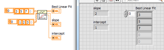

A "0" was hidden i the start of each array 🙂
