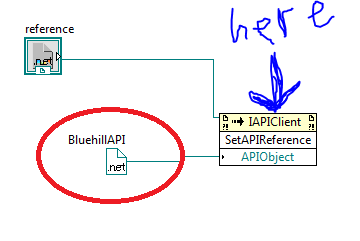

Ok, I have been fussing around with my problem and I think I may have pinned down the part of problem. When I hover over the IAPIClient property node, some text pops up briefly. It reads, "BluehillAPI, Version=0.0.0.0, Culture=neutral, PublicKeyToken=null". Now, I am no expert, but I know that the API uses 4.0 .NET, not 0.0. I was able to find some info on the null bit as well. I am not sure how to get the Key to not be null yet. (I included the picture for illustration, since I don't think this was in the initial project)

That's your problem.
You can't use a "NULL" constant.
George Zou

Thanks for the verification. It is good to actually know what the problem is. I am at bit of a loss as to how to actually deal with it. Is this a problem with how LabVIEW is handling the key, or is the problem coming from the API instead?

To fix it, right click on the constant, change it to a control.
On the front panel, right click on the control, and insert the right object from the .net assembly.
George Zou
