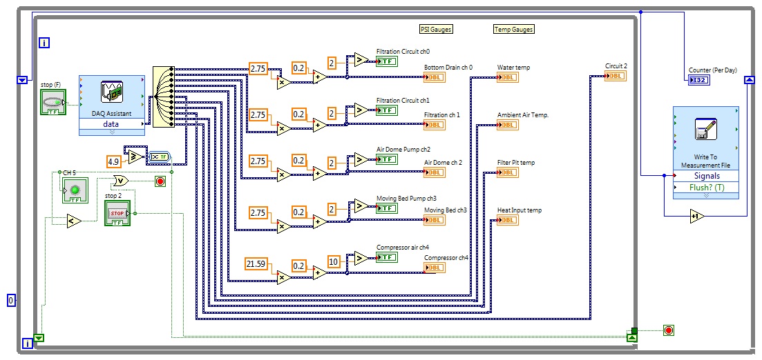

Another seemingly simple question, I have four thermal couples attached to a NI 9211 4ch Module.  I would like to be able to monitor the temperature real time on the front panel and then every 4 hours write the current values to Excel with a time and date stamp.  Just like a data logger would do at a set time interval.  This seems so simple but after hours of reading and tutorial videos I can’t seem to get anything to work the way I want.  Any guidance would be greatly appreciated.
 I have pressure gauges and a switch counter in my VI also attached to a NI9205.
Thank you,
Chad

The placement of the Write to Measurement File makes no sense. You would only write when the inner loop is stopped and you aren't even passing it any of your signals. Have you tried using an Elapsed Time function connected to a case statement with the file write inside of that?
You are using the evil dynamic data type. Are you only taking a single sample with the DAQ Assistant?
p.s. Absolutely no need for multiple stop buttons.

As you can probably tell I’m pretty new to Labview programing.  The write to file VI I have in the outer loop just counts how many times a reed switch is actuated.  I found that code in an example online, there is probably a more efficient way of doing it but it works for what I want it to do.  Not sure how I would wire it differently without Dynamic data I’m taking continuous samples with the DAQ Assistant.  If I could figure out a way to also write my temperature readings to that same file that would be great but not sure if that’s an option.  Thank you for your help.

As far as the mutiple stop buttons.  I want only one but every time I tried to wire them together in differnt ways or remove either one  it would give me an error.

Delete stop 2. Wire the other to where you had the second wired. Or, wire the stopped output of the DAQ Assistant to that place.
If your assistant is configured to multiple samples, it seems silly to discard most of the samples by writing the dynamic data to scalar indicators. Why don't you take advantage of multiple samples and take the Mean?

I guess I'm not sure what your saying by just taking the mean of the mutiple samples. Each channel is from a differnt sensor when I think of taking the mean I think of it being like taking the average. I want to know what value each sensor is putting out. Am I misunderstanding the word "Mean"?

The mean is the average. What I'm getting at is in your DAQ Assistant, you set an acquisition mode (continuous, n samples, or single sample) and if anything other than single sample, you set a rate and number of samples. If you are requesting multiple samples, then take the Mean of each channel. Your settings are all hidden in the assistant and I can't see them.

You can probably incorporate part of this code to your program  for logging data to excel on a timed basis. The link shows an example that uses the "Elapsed Time" Express VI to log data at a user-defined time interval
Continuous Acquisition with Timed Write to File
https://decibel.ni.com/content/docs/DOC-2432

I removed the mutiple stop buttons as you suggested and everything works fine. I did some reading on differnt acquisition modes and understand it a bit better I had mine set up for continuous samples and changed it to n samples. I guess I don't see any change in the way the program runs but if it takes less system resources using it this way than that's a plus. I'm still back to my original question trying to figure out how to write the data to file. I sure appreciate all the help and learning.
