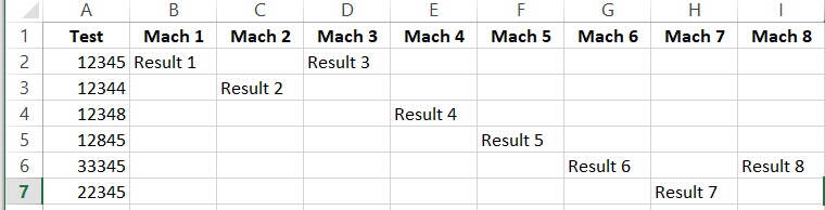

I'm not sure what you want.  If you are only doing one round of tests, I interpreted your query as wanting the following (for the data you presented), where "Result" is the result of the test:
Is this what you want?  What if there are multiple rounds of tests?  Note that you can easily save a "blank" entry if this is the format you desire ...

Dear Vinay,
     My first advice is to "throw away that picture".  You still haven't answered my question about whether you are doing one test, or many tests, but that doesn't matter, really.  The picture that you should pay attention to is a combination of the table you made (showing the 8 machines and the tests each did, but not the results) and the (Excel, but that doesn't matter, either) table that I made.
     How did I make my table?  I started with Machine 1, and its test.  I wrote down the Test (which I know is unique, because it's the First One), and made an entry in Machine 1's column.  I also "mark" Machine 1 as "done" (I can do that in a variety of ways).
     Now, I want to check each (other) machine to see if they have the same test.  If No, I write a "blank entry", and if Yes, I write the Result (and mark that Machine as "Done", also).  Since I'm doing this in order, everything lines up and I have written Line 1.
     Now I'm ready for Line 2.  I again go Machine to Machine.  If the Machine is "Done" (like Machine 1), it's a Blank Entry.  When I find the first Machine that isn't "Done", I put its Result in its Column and its Test in the Test Column (just like I did with Machine 1).  Now I process the remaining Machines, looking for duplicate Tests (and either writing "blanks" or Test Results, marking those Machines as Done).
     I keep doing this, writing more lines as the number of Machines that haven't been entered keeps shrinking.  When there are no more Machines to be Done, I'm finished!
     Try this with your data, and you'll see how it work.  It's basically a loop with three steps:
  1. Skip over "previously-done" Machines until you find the first "undone" on.
  2. Save Test Number of this Machine.  Mark Machine as Done.
  3. Do remaining Machines, checking if their Test matches the Test Number.
     Many algorithms (in LabVIEW and other computer languages) fit the pattern of "Do the following over and over until you are done".  If each time you loop, the problem gets smaller (as this does), you know it will finish.  Many times, you can state what to do simply (as we did), maybe having to remember a little bit each loop (as we did).
     There are a number of "loops" here (key "loop" words are "until", "while", "do".
     Do a Pencil/Paper run through your data example, then try it in LabVIEW.
Bob Schor

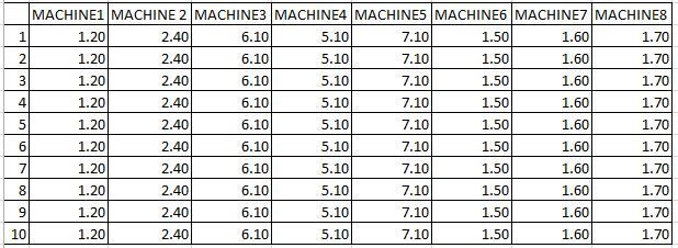

Hello Mr Bob Schor,
The test is running many time continuously all day
And we are doing 10 test for every samples and i want to save the excel with test order number as show in the excel sheet bellow
The test order number i will specify in the front panel of program at every block of test inputs at front panel as string input
and test is running parallel by different people
for example if person 1 is running test M1,M3,M5 under 12345 test order number and the same time person 2 running M2,M4,M6 under 112233 test order number and person 3 is running M7 and M8 under 223344 test order number.
when all test is completed the person will click save button and M1,M3,M5 test has save under 12345 test order number making remainig 5 test to zero in excel and M2,M4,M6 test under 112233 test order number making remaining test to zero at excel and M7, M8 test under 223344 test order number making other test to zero at excel
hope you understand
