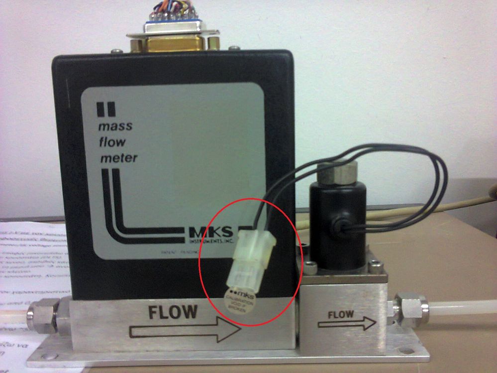

Take a look at the image. In the red circle are the two cable sockets of the 248 valve.
Since I didn't know that the setpoint pin (pin 8 at pr4000) wasn't senting the correct voltage for the setpoint number because I didn't press the ON button (hope I don't confuse you), I drove the valve with an external voltage source and figured out its range (about 7<V<10). So, now that I know that the setpoint pin of the pr4000 works as it should, I will check in a couple of days the following: connect the setpoint pin 8 and ground pin 11 to the valve sockets  (instead of the external voltage source) I aspect  to control the flow with the setpoint voltage of the pr4000. I don't see how it is possible to create a loop in which the flow will be compared to the setpoint but I think I will be ok with just setting the setpoint. I will also check the actual flow (via Labview) to see if it equals the setpoint.
Finally, the 258 flow meter is connected to the pr4000 through the 15 pins.
Message 49 of 80
(2,283 Views)
Hey,  it seems that the pin 8 (setpoint ) can't give the required current for the valve 248a even at 10 V. It remains closed.
I can control the  valve through an SMU which can supply enough power for the valve. The problem is that the sccms are dropping, I suspect because the SMU can't compare the flow signal with the setpoint signal (of course). I know that the 260 controller for that valve works by comparing the actual flow signal with the setpoint and producing an error voltage, so it autocorrects continually the setpoint signal to maintain the specified setpoint.
The question is the following:  Does the pr-4000b work with that principle? Or it acts like an SMU, giving a fixed voltage?
If it autocorrects the setpoint signal continually according to the flow, I may install a voltage amplifier after the pin 8 in order to have the proper power for the valve. (pin 7 = 15V opens the valve)
