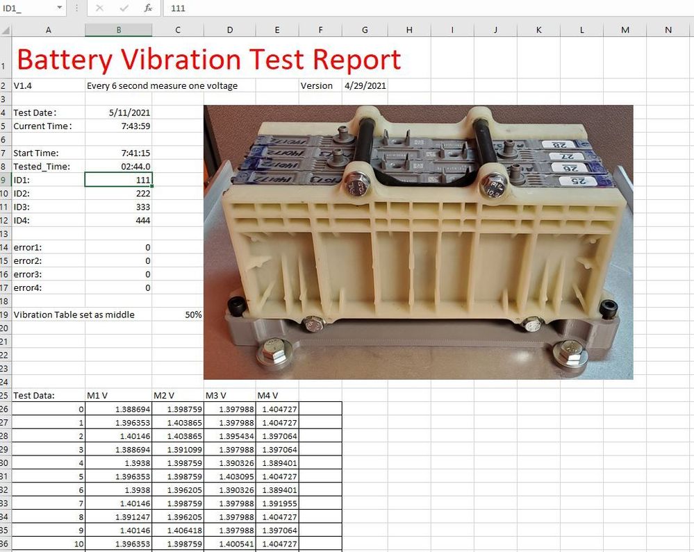

I didreport.JPG it ,looks good. see the picture.
