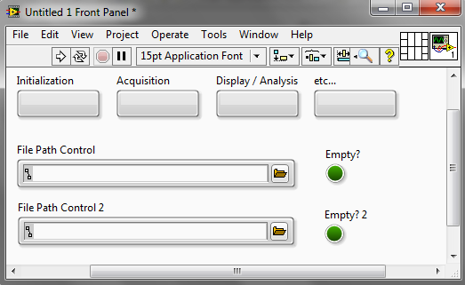

I am doing some 3D real-time measurements along with object detection/tracking. Currently, all my program modules (initialize, acquire, display, analize,...) are a part of the same .vi.
It would suit my needs better if these were in fact seperate modules that can be accessed via a main GUI application (the common denominator for all modules should be a path to a file or folder, etc...). For example:
So, when I run the "Untitled 1", I can select the individual modules. When I select the "Initialization" for example, I would want that the "Untitled 1" still runs in the background (with some intuitive loop delay to not load the CPU) and that a new .vi opens (and runs automatically). So, when I close the newly opened .vi, I can return to the main GUI ("Untitled 1) and continue working...
What would be the best / easiest way to do this?

Use a queued event-driven producer consumer loop with each of your subVIs set up to pop up in your consumer cases.  The event-driven producer loop queues up elements, which are dequed in the consumer loop.  This is a standard design pattern and a template for one take on this is found in the built in help.

Hi Klemen,
 Please have a look at the VI which will open the VI from another VI.

thank you for the prompt answers.
@carlos_camargo:
In this case, I think the producer - consumer loop will make things more complicated...
@srikrishnaNF:
This seems like a really simple solution. Do you use such technique to handle simple dialogs as well as more complex?
I will try this, since it looks promising in my case.

Hi Klemen,
   That SUBVI based pop up dialog can handle more complicated as this is implemented as a sub-VI.
