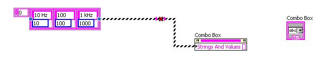

Thanks, I am making progress.
Any idea how to fix this problem? I saw this working in an example. In the labview example, the pink rectangle above "StringsAndValues[]" was blue. How do I make it blue? Thanks.aasd.JPG

Hi Doom,
when switching on the context help for that property you would see that it requires an array of cluster of 2 strings...
What do you mean by "array location"? If you want the index of the choosen string you have to do a 1d array search through the array given by property "String[]" (or through your array of strings, as you want to set those strings anyway).

You can only pass strings into this property node (pink). What I would suggest is just to use the Number to Decimal String conversion VIs to convert your integer (blue) in to string. Then build a 1D array of these values and pass it to the Strings[] property for the Combo Box.
