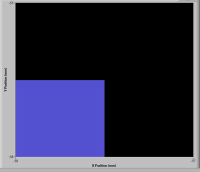

Here is my problem.  If I first load a 20x20 array of doubles into my intensity graph, this array takes up the entire field of view. If I later load a smaller 10x10 array, only a quarter of the field is occupied as shown below.  Conversely, if I load a larger array, not all of the contents are displayed
Is there any way that I can rescale this graph (for lack of a better term) to work with inputs of different sizes?

Here is a simplified VI, as requested.  If you click on the toggle, you can see that one of the images occupies the entire graph, whereas the smaller one doesn't. This creates a problem for us when we attempt to load images of different sizes.
Any suggestions for how to approach this?  I tried a bunch of properties in the intensity graph, but none of them did the trick.

Turn off "loose fit" for both axes or change the axis formatting to show at least two decimal digits.
(With loose fit enabled, it will round to the nearest "nice" value for the limits, which is tricky with a 0.05 increment and markers limited to zero digit precision, i.e. whole numbers.)

That did the trick. Thanks. I do have a problem with the x- and y-axes, but that's a separate issue that I'll raise later.  Again, thanks.
