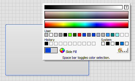

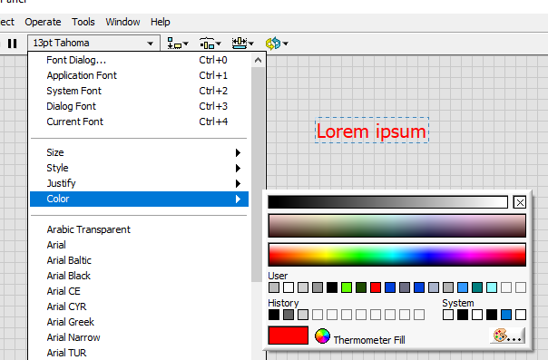

@greenbean209 wrote:
So how about the blue outline around the main boxes?
Each object (control, decoration, indicator, etc.(except system palette items)) has a fill color and an outline color that can be set differently. You need to play with the space bar while selecting on the color palette to operate on the two colors separately, which takes a bit of practice.
Here's how the silver rounded box looks with the outline in blue.
(Note that the selected color in the lower left of the palette contains two different colors, one for outline and one for fill)
For fonts, just select the font and pick a color from the font menu.
