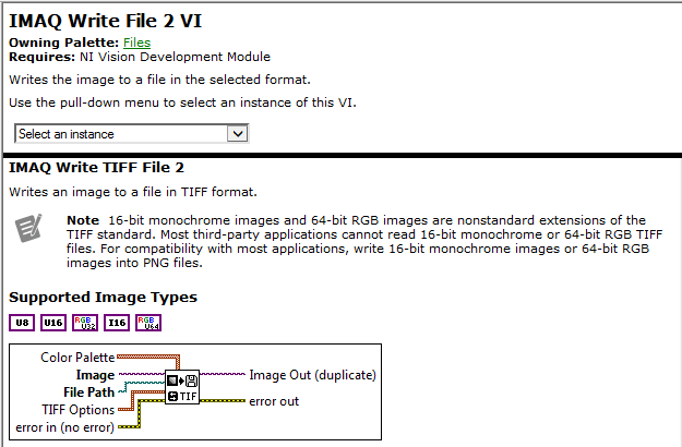

From the 2015 Help, it looks like U16 images are supported by IMAQ Write (TIFF), but probably not supported by other software that reads TIFF, as noted in the help.
Thanks for your time - Chris
