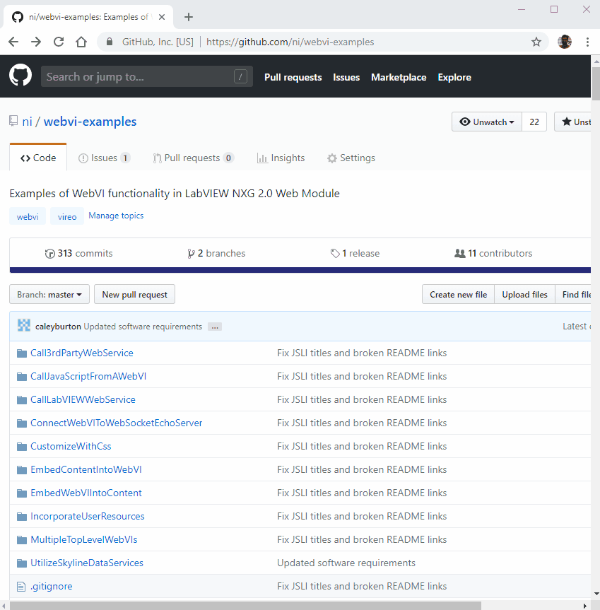

The recommended way to share resources between multiple top-level WebVIs is to place them in a single component. The Multiple Top-Level WebVIs example on the https://github.com/ni/webvi-examples page demonstrates how to organize a Web Application Component with multiple top-level WebVIs. When the page is built the generated output will create one copy of the shared resources (including vireo.js) that the browsers will be able to cache efficiently.
The following gif shows how using the Multiple Top-Level VIs configuration and a server that is well-configured for serving files in a manner that can be cached can be verified in Chrome Developer Tools.
Note that even with proper caching there is still time needed to run the cached scripts when a page is loaded. This is required each time a page is visited regardless of caching behavior.
The other alternative is that instead of creating multiple independent web applications that share resources, you can create a single web application that dynamically updates the single front panel. This can be achieved in NXG 2.1.1 using a tab control and treating each tab as an independent page. Unfortunately LabVIEW NXG 2.1.1 does not currently provide features that make this approach a first-class experience. It is not possible to hide the tab header from the editor without custom styles, we do not connect the tab transitions to the forward and back buttons of the browser, the url is not updated based on current tab selection, etc. In web development terms this kind of single page experience is referred to as a single-page application.
