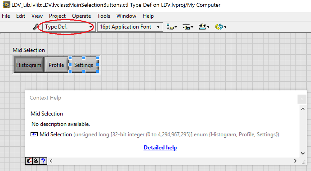

Glad to hear it worked out. I saw your VI now and whilst you can wire the 'knob' control you had already directly to the case structure, in that situation a default case is required and you can't use the convenient right click > 'Add Case for Every Value' option. Since a radio button behaves like/is an enum, it has a defined set of values which makes it really simple/nice to use with a Case structure. (You can also use an enum control directly, but maybe the radio button suits your visual design better?)
As a follow-up note, if you don't like the appearance of the radio buttons, you can right click on the control and choose Advanced > Customise and then in the window that opens use the right click > Replace on each element of the radio button control and choose a different boolean control appearance (like a button, rather than the circular dot). If you do this, don't forget to consider using a 'TypeDef' control rather than a simple 'Control' - then your data type is saved as part of the control.
