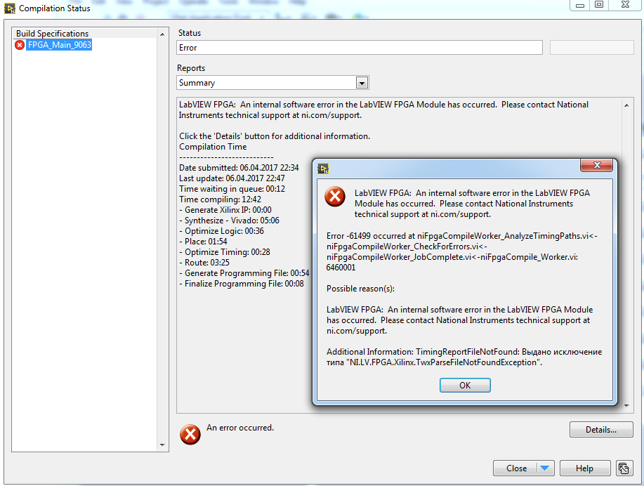

Just moved from 2014 to 2016 my FPGA projects and faced an error:
Error -61499 occurred at niFpgaCompileWorker_AnalyzeTimingPaths.vi<-niFpgaCompileWorker_CheckForErrors.vi<-niFpgaCompileWorker_JobComplete.vi<-niFpgaCompile_Worker.vi:6460001
Additional Information: TimingReportFileNotFound: exception type "NI.LV.FPGA.Xilinx.TwxParseFileNotFoundException".

These don't work. I've tried to reinstall all software components - the result is still the same.
Error arises on finalizing file step and is based on a report file missing.
My CLIP uses additional timing constraints and they worked normally in 2014 on the same target.
