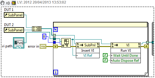

Hi ace,
Yes the array and for loop is work! Appreciate your idea, this saves me a lot of job!
Now I am thinking how to simplify the area as shown in picture below.
If i create a string combo or numeric control in the front panel, for user to select the quantity of device to go for testing.
After the selection, lets say the quantity = 5 subpanels.
So in the block diagram, is there any way to auto create 5 reference of different subpanels, link them to 'build array function' and 'for loop'?
Or pre-create the references of subpanels for every single case of quantity selection, is the only solution?
Thanks.
Message 4 of 8
(4,641 Views)

@TanTan wrote:
Hi ace,
Thanks.
You can Open reference to a file (.vi) in a loop, just add some function to generate the name of which file to open, e.g. Subpanel1.vi and so on, and it's quite simple to generate and open the references.
/Y
Qestit Systems
Certified-LabVIEW-Developer
Message 6 of 8
(4,626 Views)
Bundle the references and then use a array subset or something similar to extract a portion of the array of subpanel references. So if you have 10 subpanels, and the user selects, 3. Derive the first 3 elements from the array and use it in the for loop as before. Hope this helps.
