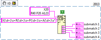

I am new to labview and was having some difficulties using the Match Regular Experssion Function.
I am using labview to communicate with a sensor.  I have installed the NI device driver to do so.  The output of my sensor is in the format,
X20
R40 P20 A123.  The numbers in this case are arbitrary.  I am trying to use Match Regular Expression Function to display and perform mathematical operations on the numbers.  I am having difficulties formatting the input string on the Match Regular Expression Function.  Could you please give me some tips on how to format the example I provided.
Thank

Here is a way to do it if the format is constant (X R P A followed by a positive integer number).
