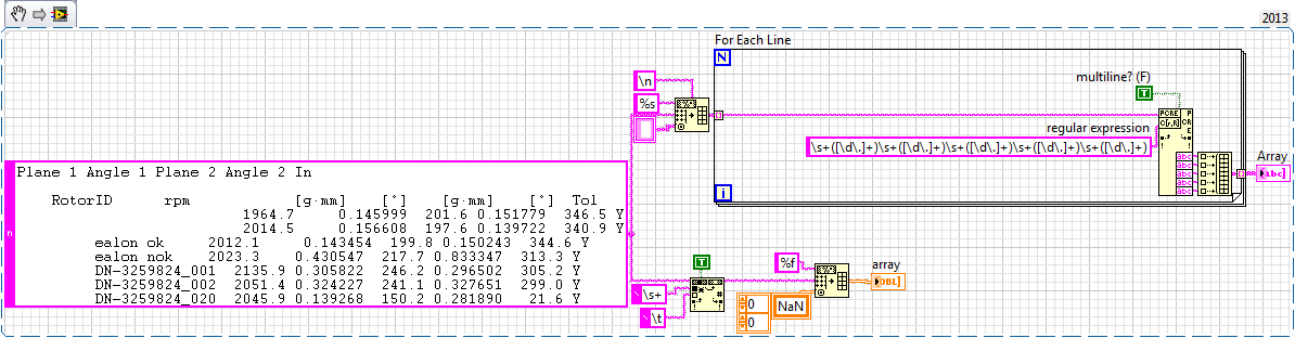

First use "Scan String For Tokens" then pull the float out of that.
This is from my library that I use to do exactly that.
Omar
(4,052 Views)

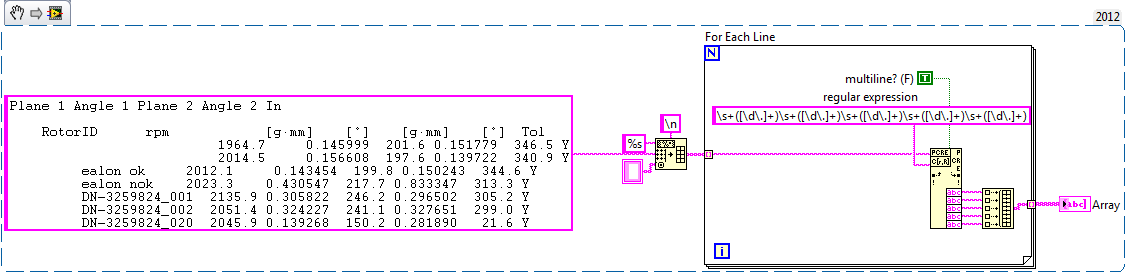

If you wish to use a regular exprission.
Omar
(4,035 Views)
Of Course,  There are easier ways to get those floats out of the serial device string.
The worst part is getting rid of all the extra spaces.  Use match pattern (regex option) to help out a bit:
