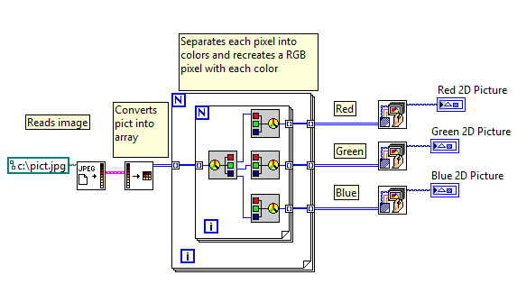

 You can easily loads an image from a file, separates the colors, and recreates an image for each color using the tools available in Labview without the Vision toolkit. Below is an example of how to do it.

That's great.  Are you able to share that example code with me as a vi?
Cheers,
Wes
(3,924 Views)

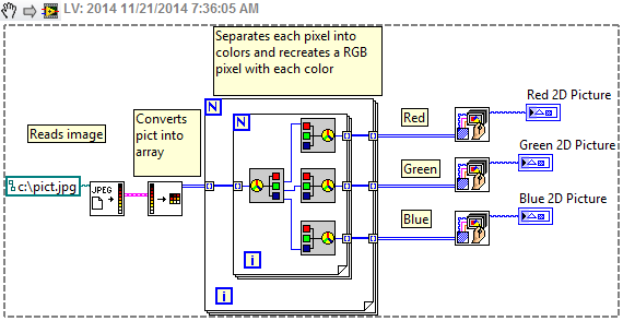

Sure, here it is saved as 2010 version and as a snippet as well. As a side note, I initially wanted to give it as a snippet but I realized that the Code Capture Tool cannot be installed on Labview 2014. I am surprised that it is not mentioned (as far as I can tell) in this forum. I found the solution on JKI website. It's a bug in the version of VIPM provided with Labview 2014. A new fixed version of VIPM can be downloaded from JKI website.
