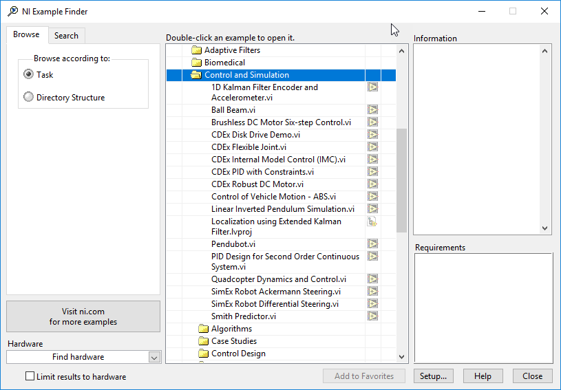

You can find more examples using the built-in Example Finder.
With LabVIEW open, go to the "Help > Find Examples..." menu option to open the Example Finder tool.
It will have a couple of options to help you search, although it can be a little finicky...

@teoprot wrote:
One last question: the examples about the Control & Simulation toolbox you mentioned are found here : http://www.ni.com/tutorial/11653/en/ or am I missing something ?
Yes, you are missing "The Examples that Ship with LabVIEW".  Open LabVIEW, go to Help, Find Examples.  I don't have the CDS Toolkit installed, so I looked in the Folder "Toolkits and Modules Not Installed" and saw this:LabVIEW ExamplesLabVIEW Examples
Bob Schor
