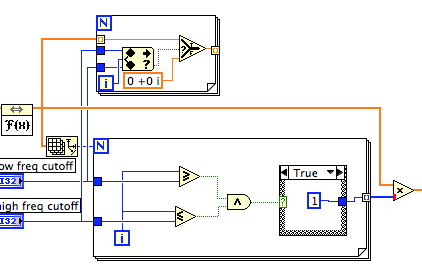

Beyond what crossrulz has mentioned the explanation for the '39m' value you saw is that the FFT will be interpretted as having a sample rate of 1 sample per second in the absence of any other information.
The for loop can be replaced by the simpller loop above it in the image below. This has the advantage that it does not need to allocate memory for the 0,1 array.
