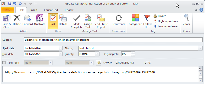

An update to a thread once every 7-8 years is just proof that LabVIEW is here to stay!
Message 9 of 13
(5,619 Views)
I'll be ready. 😄
Jim
