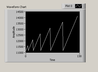

I think you are piling all of your draw commands.
As a quick test type cast your picture wire as a string and drop a string lngth with indicator so you can see how big the data in the picture wire is. To avoid the pile up start with a blank picture constant(erase if you want) so that you don't keep building a bigger and bigger draw list with each update.

I've also tried to typecast the picture wire to a string and got a broken wire! However the 'flatten to string vi' did the job and I tried what you suggested. Each time I click on a well the subvi is executed 6 times. I fed the string length into an array and got a 'wire size' for each loop iteration.
What you see is my base size seems to be about 11000 bits. Each saw tooth corresponds to a click of the mouse. So the wire size is definately growing  more every time....although it seems to be starting at the same size each time also! I have to be honest and say I don't really get whats happening here! And also this is just 6 loops of the for loop - I'm sure with 1000 it must grow massively!
