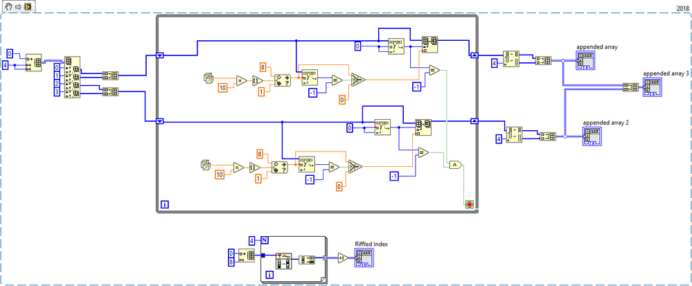

Sometimes BD Real Estate is worth more memory than the array size (easy enough with blue wires)
Postage stampPostage stamp
Your BD is too big and the While loop is not guaranteed to exit, you need a timeout!
Message 4 of 8
(4,159 Views)
Jeff, your code does not guarantee that each card exists exactly twice. Here's what I would do.
Still, the instructions require the convoluted use of subVIs and to generate the array in steps by trial and error, so this cannot be used anyway. 😄
Use Riffled Index ! simpler!
No, then you would get numbers [1.. 16] once each instead of [1 ..8] twice each.
(If you use the riffled index, you would need to e.g. add a Q&R and continue with the remainder, for example. More code!)
