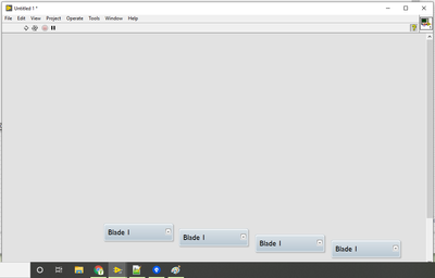

I'm reviving this old thread because after 16 years it appears to still be a cosmetic problem.

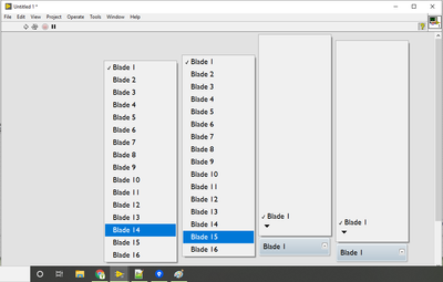

Shown below is a VI with the same text ring control placed four times with increasing closeness to the bottom of the screen and I've demonstrated what you get when you select them.
The menu fails to properly display the entries if the control is within, roughly, 20 pixels of the bottom of the desktop area. Note that all four controls render the same if I move the window up the screen and away from the bottom of the desktop, so this rendering choice is related to on-screen position, not Front Panel position.
I don't accept this is intentional, the large blank area is very undesirable and gives the impression of a rendering mistake. I dislike it, and need a workaround if anybody knows of one please?

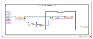

I don't love it, but this seems like a note-worthy workaround:
On Mouse-Down?, if you rearrange the StringsAndValues such that the current value string is at the bottom of the list, then you will never get the annoying bug being discussed here since the current value will always be on-screen.
