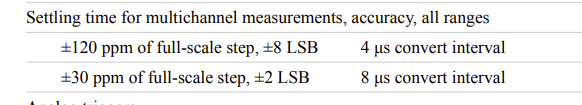

Your question is answered in the instrument datasheet
The accuracy will be thrice worst than the 8us covert interval.
Santhosh
Soliton Technologies
(3,435 Views)

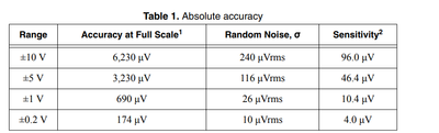

2- In the datasheet, what is the difference between the accuracy mentioned here:
and the absolute accuracy?
Which one should be considered when we want to estimate the maximum error?

I would add the conversion error on top of the absolute accuracy if you are measuring just 1 sample +/-(6.23mV + 1.224mV)
As per specifications, it uses a 100 sample average to arrive at the specification numbers.
Santhosh
