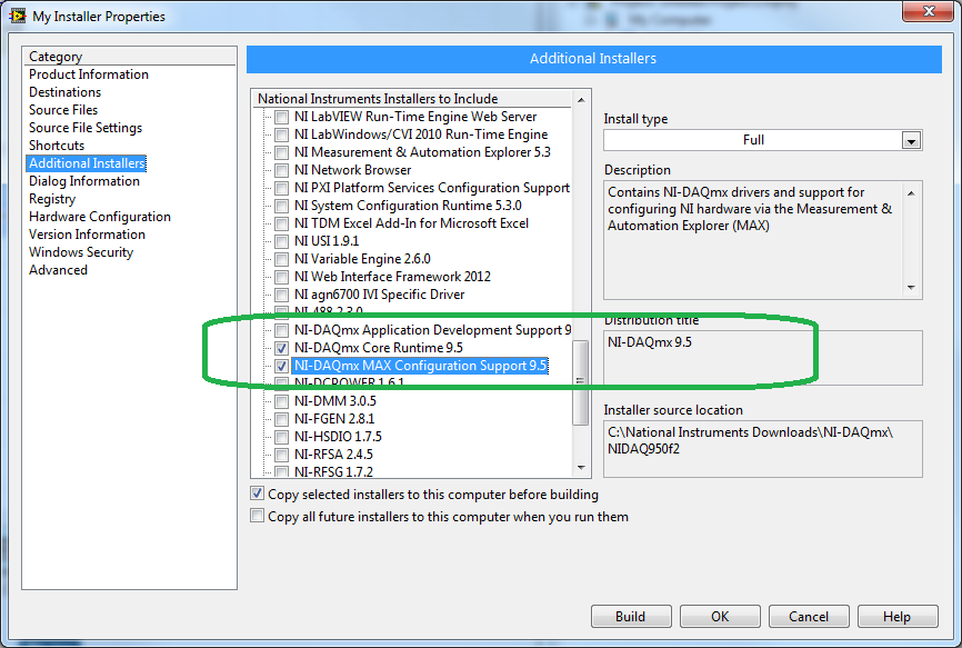

Accepted by topic author chuggins1434
nilvaiu.dll installs with DAQmx

Do I only need to check the two you have shown?  ...or do I need to check all three DAQmx files?

Hello Tellerium,
For 2012 it should be the same. If you create a new installer in Build Specifications in your project. In the Category list, you will see Additional Installers and you can select DAQmx. You will have the same three options and the check boxes underneath.

Hi ogk.nz,
Have you included all three DAQmx installers and checked both boxes at the bottom of the window as shown in amezam's post when you built your installer? There may also be a compatibility issue, as DAQmx 9.9 is not supported on LabVIEW 2009. Try reverting to DAQmx 9.7 or upgrading to LabVIEW 2010 as per this compatibility chart:
