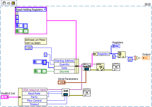

Hi
The document doesn`t help unfortunately.
I am attaching the code which I am using but it hasn't changed a lot since my first post.
Lukas

Hi stiefel,
try to initialize the boolean value you are passing to the function MB Serial Master Query Read.
Maybe this might generate the timeout error.

Try reading Holding registers instead of input registers.. Also use a bundle by name for your cluster.

Hi
Thank you for your help. I rebuilt the program as Dave has mentioned and still get the
error -1073807298 ocurred at VISA Read in MB Serial Receive.vi:3-> MB Serial Master Query.vi:2->PID-Read.vi
Possible reasons:
Visa: (Hex 0xBFFF003E) Coud not perform operation because of I/O error.
I get this same error using the set_temperature.vi and it still sets the temperature correctly. The controller also shows a little light indicating communication over the interface when running any of the programms.
So the same error as before which I have mentionend in Message 9. Any suggestions how to resolve that problem?

Have you tried increasing the timeout value? What is it set at? Also is your address the same for unit ID in the controller? You can by sending a broadcast "Unit 0" and all will except the values for setpoints (Writes) but if you request data from a controller and it does not have the same ID it will not respond.  The slave Address must be the same as what is set in your controller.

The timeout value is set to 10000 and I have tried increasing it but it doesn't make a difference. Anyway I am not getting a timeout error right now.
The slave address of the controller is set to 2. When I am using the programm "Simply Modbus Master" communication works fine.
