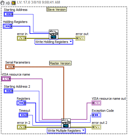

You dropped the Slave version of the VI.  Go back and drop the Master version, the instance is called Write Multiple Registers.
I've never used the slave versions because my PC is always the master talking to slave devices.  This particular VI you dropped on your diagram is a wrapper around an action engine or functional global variable to have a place to store data for the registers in the situation where you might want your PC to act as a slave device and have another modbus master somewhere talking to it.
Example_VI_BD

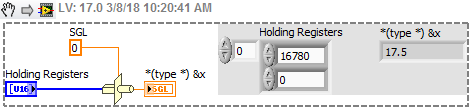

Typecast to a single precision floating point number.
Example_VI

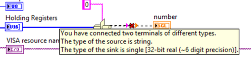

My "Single precision float" seems to be different from the typecast output. Pink vs orange? 😐
