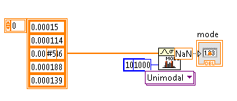

I am using the mode function to calculate the mode value of an array and it returns NaN. LabVIEW help says it only returns NaN when array input is empty. I am not sure why this happen. My array is
0.00015
0.000114
0.000146
0.000188
0.000139
I did try with mulitple value of intervals.
Thanks in advance.

I think your number of intervals needs to be less than or equal to the input array size.
If you set it to a negative number then it should always return the most commonly occuring value instead of using bins.

I have just tried to use -1 but it is still does not work.
I am not sure NaN means it cannot find the repeat value or not.

NaN in this case means that no mode was found.  Look at it this way... you have a group of numbers and are telling LabVIEW to break it up into 1000 separate "bins". If each bin has only 1 value in it, then there is no mode - no single value that appears more often than other values.
For your data set, any number of intervals < = 14 will return a mode.  Any > 15 will return NaN.
For interval = [1, 10] it works nicely - means it gives an output different to NaN…

Actually I have just found out the answer by using the historgram. It illustrated the reason very clear to me.
