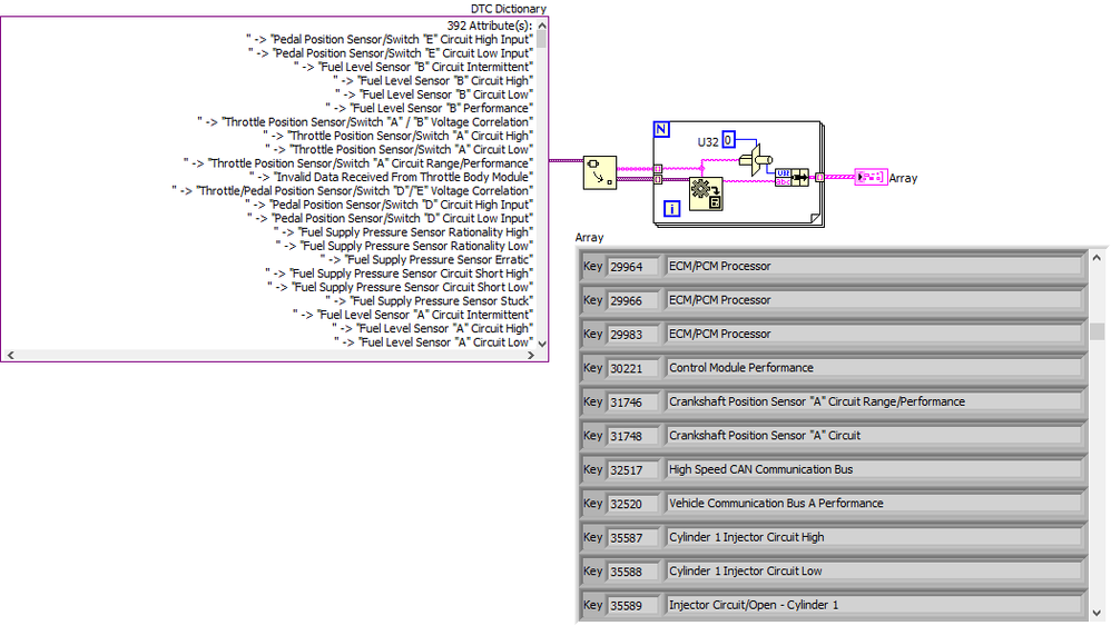

The names aren't empty strings, they're the result of whatever the "SPN" shifted 8 bits and then logically OR'ed to the FMI as a U32 is, and then that converted to a string.  They aren't ASCII characters you can read, but they're not blank either.

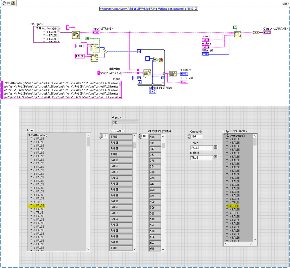

So, I would do this to replace the #19 FALSE with a TRUE
Message 6 of 15
(7,198 Views)
Accepted by AndyEngines
You can get all attributes if you don't wire a name and can create a list as follows (same for the other variant). Find the attribute name you want to change, the rewrite the attribute to get the changed variant.
