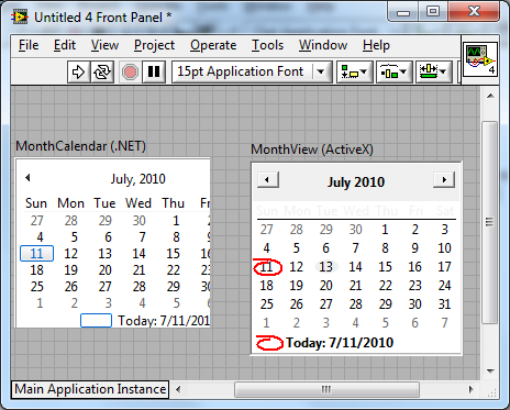

I assume RHS = Right Hand Side.
My advice is to bag the .NET calendar and use the ActiveX MonthView Control instead.

RHS = right hand side, with the example you posted that makes sense.  But that is a bit of a reach for someone to figure out that abbreviation without any example.  Why would anyone think that abbreviation is obvious?
If you look closely, it is also affected BS.
Spoiler
(Bottom Side)
Does it behave this way on older versions of LabVIEW?  My guess is that this can be classified as a bug.

Thanks!  I'll use the active X version.  I was looking for it under the old name but didn't find it.
