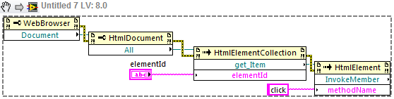

It's not entirely clear from your post whether you know this or not, but you can do something like this, which will perform a click on a specific element:
Of course, for that you do need to know the ID, and it seems that you do not. I don't know if the Javascript you posted is everything on the page, but I would expect that the tab itself would be an element and have an ID. I know that I have done things like this with Javascript elements before. That said, I'm not exactly a Javascript expert, so it's possible that elements don't always have an ID.
Hopefully, this code helps you in understanding how you can interact with elements in the browser. You should be able to find the other options for what you can do online.

In this example I actually used a .NET control, because it's more modern than ActiveX and the type system is generally easier to work with. The web browser control can be found under System.Windows.Forms.
Also, the image is a snippet. The icon on the top means you can save the image to your HD and then drag it into a BD and it will be dropped as code you can edit and run.

tst,
Thanks and I checked the class, system.windows.forms of .NET before your reply.
I couldn't find the property of HtmlElementCollection you mentioned. In my case, I could do select only "count".
As a beginner, I am very confused for realization of the solution.
Can you post simple example vi (right property of class)?
Wow, how can I navigate the web address in .NET webbrowser? I can't find the "navigate property".
Message 5 of 11
(9,599 Views)
Accepted by topic author labmaster
There's a .NET web browser control (where I said) and it has all the relevant properties and methods:

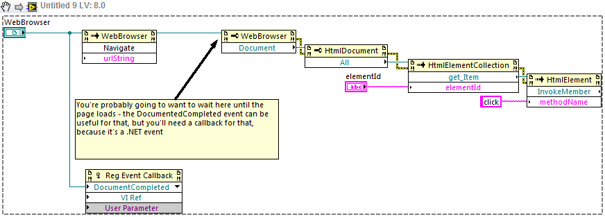

Dear tst,
Thanks for your hint in my trouble.
However, I would like to know more about callback event with .NET to check if the page is loading completely.
Can you tell me more hint for this? I have no any experience .NET and callback event.
Thanks again.
Message 8 of 11
(9,564 Views)
Read the help for the function and look at the shipping examples. Basically, .NET events and LV events don't really fit, so you set up a VI which gets called whenever the event occures. You can use that VI to trigger a separate LV event. The details of each specific event are yours for the finding (since it's MS, it's on the MSDN).
