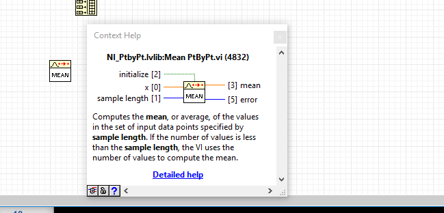

Pt by Pt Mean
May help but you may want a oh say a 10 order eliptic IIR filter - there  is one of those on the pt-by-pt palattes too

Yes, mean-ptbypt will do the averaging for you, so get rid of that while loop you show.
